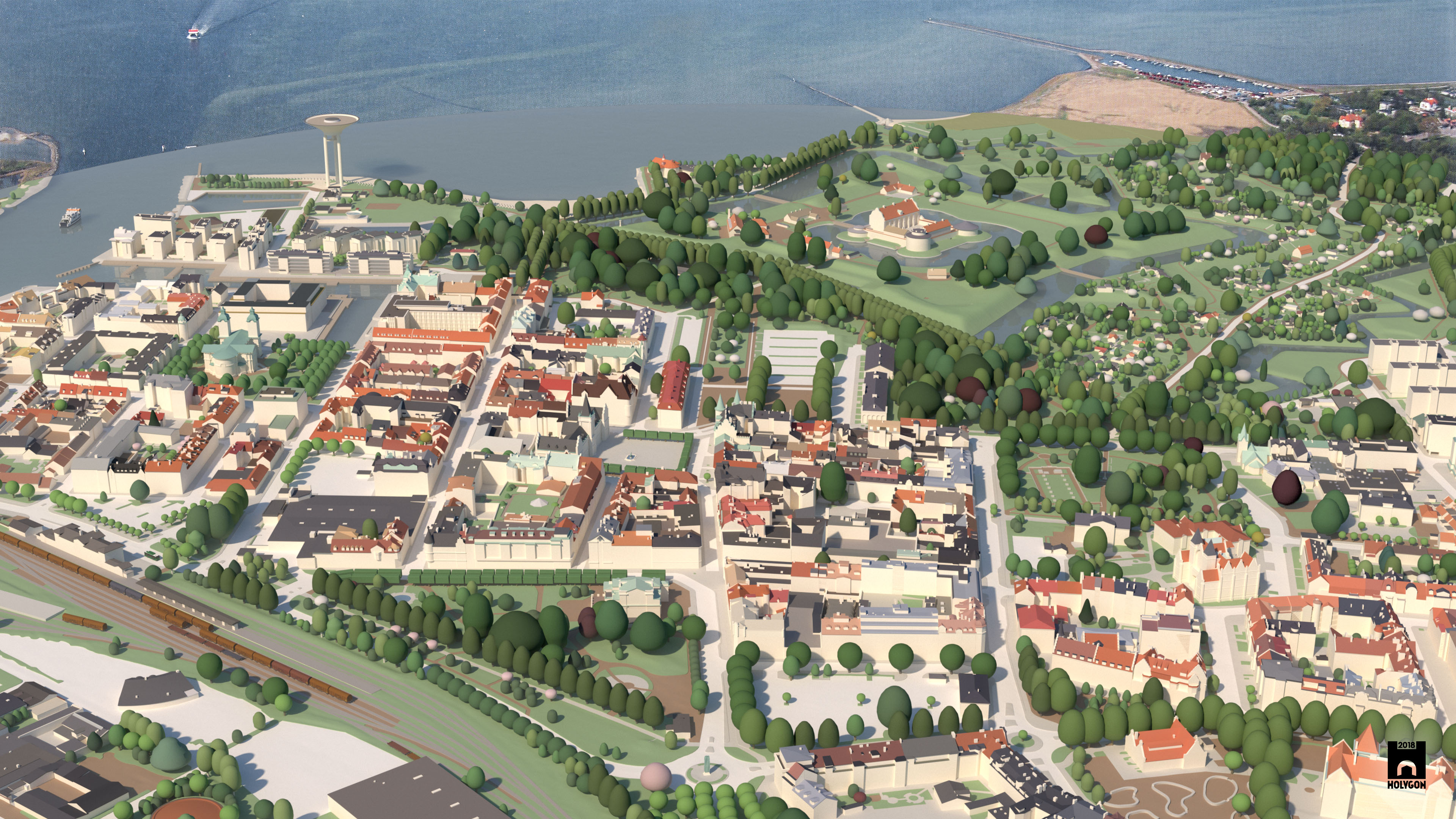

Felix and Anders inspect their 3D-printed model of the Swedish city of Landskrona during the unveiling ceremony.
