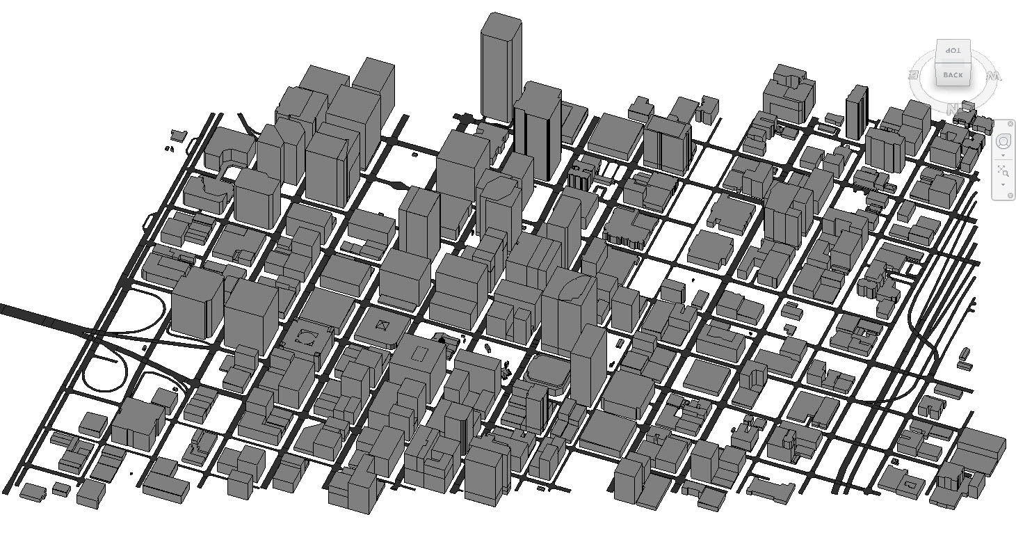

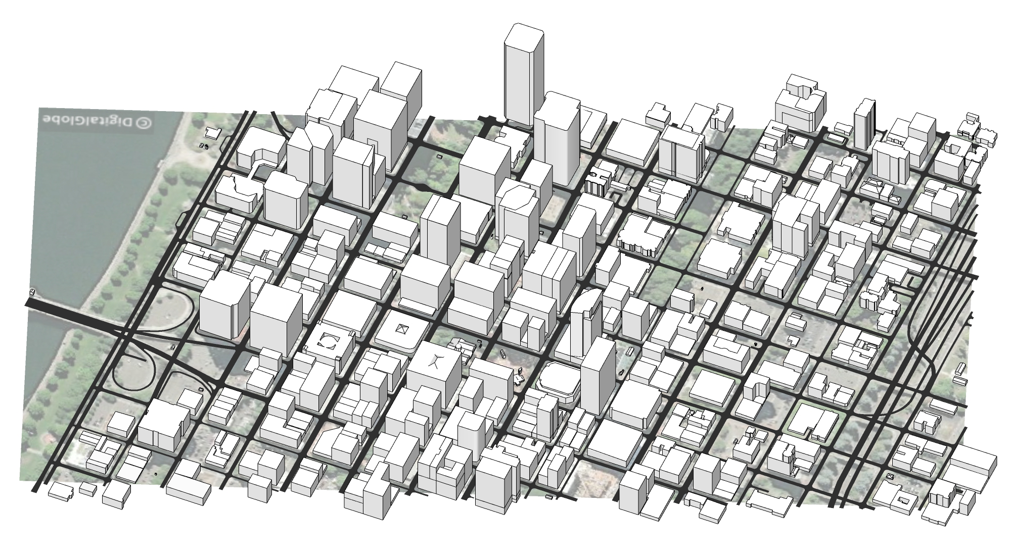

Image one: the original SketchUp model. Image two: the SketchUp model linked in a Revit project

2. SketchUp as a "Link" in a Revit Project
SketchUp is often used to create detailed site or context models in the early phases of the project. Instead of duplicating this work in Revit, import your SketchUp models as a “link” of site plans, renderings, and 3D views to show additional urban context, detailed adjacent structures, or infrastructure. With this workflow, the SketchUp model appears as is in the Revit model without remodeling these aspects.
